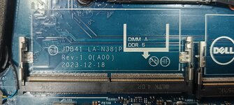

Please I need this Bios & Ec file for Dell Latitude 5450
MODEL: DELL LATITUDE 5450
MB: JDB41 LA-N381P REC:1.0 (A00) 2023-12-18
CMIIT ID: 2023AP20874
REGMODEL: P165G
ST: 29B1WH3
W25R512

please send bios backup
